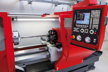

Fagor 8055 T Lathe
Fagor 8055/8055i T programming G codes / M codes complete lists.
FAGOR 8055 T
