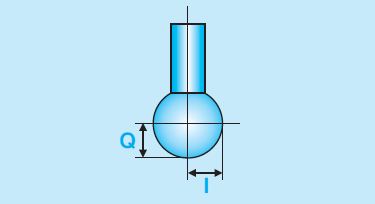

G49 Defines spherical mill radius (for G841/G736/G726)
Selca G49 Defines spherical mill radius (for G841/G736/G726)
Selca G49 Defines spherical mill radius (for G841 G736 G726)
G49 I... [Q...]
Parameter Description
I spherical mill radius.
Q distance between tool zero and tool tip:
Q=I: if tool zero coincides with tool center.
Q=0: if tool zero coincides with tool tip (default).
Enabled: until a G49 or a T for tool change is programmed.

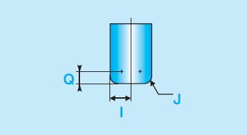

G49 Defines toroidal mill radius (for G841/G736/G726)
Selca G49 Defines toroidal mill radius (for G841/G736/G726)
Selca G49 Defines toroidal mill radius (for G841 G736 G726)
G49 I... J... [Q...]
I toroidal mill radius.
J distance between tool zero and tool tip:
Q=J: if tool zero coincides with insert center.
